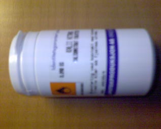

(taken with my cell phone, btw)
I have bought 90 grams of potassium nitrate (KNO3) and have already tested it using powdered sugar (melis) and then trying regular sugar.
I have found out that powdered sugar (melis) was too fine of a grain, and didnt 'burn' all that much. Then I went over to regular sugar, using half a teaspoon of each (ca 50/50), then saw a way bigger flame. (I was thinking that it wasn't going to be such a big flame, but it was huge compared to the powdered sugar, hahaha! It was a little scary moment there, surprising how only a teaspoon of propellant could produce that much energy).
Anyway, I think I will try to buy KNO3 at felleskjøp instead of a pharmacy, because it is too expensive (100kr for 90grams) and I would rather buy 25 kg for 200 kr. ;) Although if you buy it at felleskjøp, would it be the same type of grain?

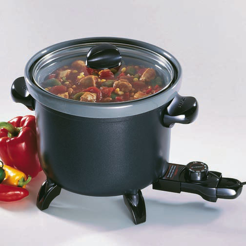

Ok, I need to try to find a thermostat cooker (for casting of the propellants). Does anybody know where I could find/buy one here in Norway? It is electric and needs to measure the heat accurately with a "built-in" thermostat.
Here is an example of one:
"Presto Multi Cooker"

Kansje det er en idé å bruke gassbluss+rel. tynn panne (el.) (rask reaksjon), pluss en form for eksternt termometer (IR er vist det beste og enkleste)?
6256951[/snapback]
No, I need something that is accurate and effecient (something that I don't need to "worry" about). I'm pretty sure I could get ahold of a thermostat cooker, going to look at Claes Ohlson or Jernia; which Zethyr suggested. :thumbup:

Joda, men har en følelse av at "termostatkoker" på Claes Ohlson (hold deg langt unna Jernia, drittbutikk) kansje ikke er supernøyaktig.

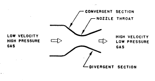

Hm, where to start...
Well first of all this is how a rocket "works":
*very basic concept

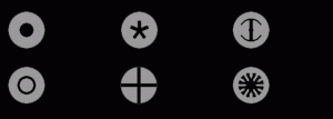

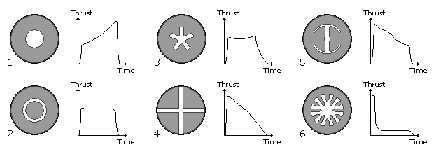

Then here are some different stuctures of the propellant (oxygen + fuel) in the combustion chamber of the rocket motor:
*the most common types
*other examples
To create these structures you would need to "melt" the propellant togethor, or use some sort of "binder". The most common type of propellant used for model rockets is the KN/SU type, which is KNO3 + C6H12O6 (sugar). For this type the easiest option is to "melt" it...

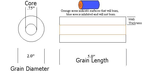

Here is a picture showing some common terms used in rocketry:

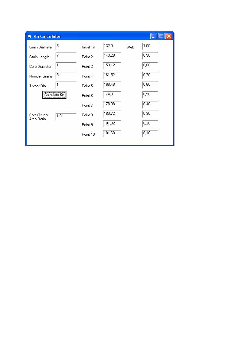

The nozzle size can vary, but is "usually" 1/5 of the grain diameter. It depends though, some can be 1/3 of grain diameter. Size, propellant, grain structure; all play a role in the calculations of the nozzle. The "hollow-cylinder" type grain (as in picture above), should have a core area that is twice the size of the nozzle (throat area)...
The KN/SU mix should be a 60/40 mix, some say its better with a 65/35, but it depends on the particle size of the grain and the different pressures/temperatures its being used in...
