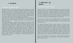

BiaZ Skrevet 16. februar 2005 Del Skrevet 16. februar 2005 (endret) Holder for tiden på med å lage en hjemmeside til klanen min. Problemet er at jeg i firefox ikke får linjeskift, Mens i explorer og opera er det ikke noe problem. Derfor lurer jeg på hvordan jeg skal få linjeskift i en tekst i firefox også. Som dere sikkert skjønner er jeg totalt nybegynner på dette feltet. Edit: Formulerte litt annerledes. Endret 16. februar 2005 av BiaZ Lenke til kommentar

BiaZ Skrevet 16. februar 2005 Forfatter Del Skrevet 16. februar 2005 (endret) Få se sammenhengen, da:) Slik har jeg skrevet det: <td width="84" height="501"> </td> <td width="390" valign="top"><p class="style4">The History of Northern-Saints</p> <P class="text_" style="TEXT-ALIGN: justify"> Northern-Saints is a clan that developed from Beyond the Light, former clan. We were 4 members from Beyond the Light who found out that we could use a change of scenery. aZec (now known as murdoch), BiaZ, Pryzer and DayWa|ker (now known as Quintas). We are a friends from a place in Northern Norway called Tromsø. We found out that we did not want to have any outsiders in our clan, so we agreed to start a new clan with three more members. also friends. They were IceW0lf, Madusius and Undique. <br><b> </br></b> As to the name of the clan, we all digged the movie "The Boondock Saints", and we could not just take that name. So we figured out that since we were in Northern Norway, we could call us the Northern-Saints. <br><b> </br></b> We started playing in March 2004. When the summer came everybody got a little bit tired of Counter-Strike, so we came to the conclusion that we should take a brake. The brake did us good, we came back stronger than ever. With a new player. Bendl is a little brat with an amasing aim, a rising star. So we took the job of teaching him the basic rules of team playing. He was in the linup we had for the NaIT party, along with BiaZ, Madusius, murdoch and Quintas. We finished 6th at the NaIT party, with a bit of unluck. We made fools out of our selfs, managed to loose a game we were almost certain to win. Againts the former players of Catch-Gamers. <br><b> </br></b> Now we are planning on joining the Counter-Strike Norwegian Leage (CSNL). And so the champions of the Norht continues on their way to the TOP. <br><b></br></b></P> Som sagt, funker kun i opera og explorer. Endret 16. februar 2005 av BiaZ Lenke til kommentar
mohuhau Skrevet 16. februar 2005 Del Skrevet 16. februar 2005 Dette er egentlig avsnitt så du skal bruke <p> og ikke <br>. Så det blir slik: <td width="390" valign="top" class="text_" style="text-align: justify"><h2 class="style4">The History of Northern-Saints</h2> <P> Northern-Saints is a clan that developed from Beyond the Light, former clan. We were 4 members from Beyond the Light who found out that we could use a change of scenery. aZec (now known as murdoch), BiaZ, Pryzer and DayWa|ker (now known as Quintas). We are a friends from a place in Northern Norway called Tromsø. We found out that we did not want to have any outsiders in our clan, so we agreed to start a new clan with three more members. also friends. They were IceW0lf, Madusius and Undique. </p> <p> As to the name of the clan, we all digged the movie "The Boondock Saints", and we could not just take that name. So we figured out that since we were in Northern Norway, we could call us the Northern-Saints. </p> <p> We started playing in March 2004. When the summer came everybody got a little bit tired of Counter-Strike, so we came to the conclusion that we should take a brake. The brake did us good, we came back stronger than ever. With a new player. Bendl is a little brat with an amasing aim, a rising star. So we took the job of teaching him the basic rules of team playing. He was in the linup we had for the NaIT party, along with BiaZ, Madusius, murdoch and Quintas. We finished 6th at the NaIT party, with a bit of unluck. We made fools out of our selfs, managed to loose a game we were almost certain to win. Againts the former players of Catch-Gamers. </p> <p> Now we are planning on joining the Counter-Strike Norwegian Leage (CSNL). And so the champions of the Norht continues on their way to the TOP. </P> Jeg har her også lagt litt av cssen over i tden slik at du slipper å få det på alle p-elementene. Grunnen til at <br>-ene dine funker er nok også det at du har satt </br> som egentlig betyr slutt på <br>. Dette ser utrolig nok ut til å fungere som linjeskift i IE, mens firefox gjør det rett og bare viser et linjeskift (den først <br>-en) Lenke til kommentar
