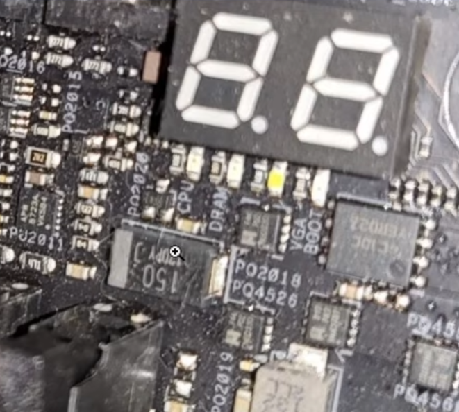

5 minutes ago, Christian Thork said:
ASUS ROG Z690 Hero motherboards are scheduled to be recalled soon due to the discovery of a major design flaw in the memory slots that could also be a potential fire hazard
All of the affected boards seem to have been made this year with this part number: 90MB18E0-MVAAY0, and have serial numbers beginning with MA, MB, or MC. So if you can check, go ahead and take a look at the board in your system.
Most reports of these issues look to be concentrated in North America for now, as per ASUS' post on the ASUS PC DIY Group on Facebook. So for now, anyone who bought their boards elsewhere in the world could be safe from the problem unless indicated otherwise.

8 hours ago, Nizzen said:
En på OCN i dag som ikke hadde problem, men kjøpte et nytt i tilfelle:
Circuit component Audio equipment Font Electronic engineering Electronic component
Capacitor aka kondensator på norsk og backwards ikke "upside down" 😛
Det meldes også om at dette er en batch som har blitt feil montert pga. feil  på produksjonslinja. Ergo kan man sjekke dette med serienummer.
Ellers er det veldig enkelt å visuelt sjekke (ta bilde med mobilen) om kondensatoren er montert riktig vei.
