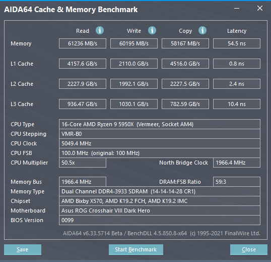

The deed is done, have gotten this fully stable
  • BIOS 3501 with AGESA V2 PI 1.2.0.2
  • dual CCD 5950x
  • 4x8GB gskill 3600 CL16
  • 1900:3800 @ flat CL14 + T1 GDM-OFF
Screenshot of TM 1umus 25 cycle + Memtest 20000% stable (do notice this is my old bloaty windows install with lots of stuff running in background)finale-png.2490191Newest OCCT 8.1.3 1 hour large dataset extreme + 4 iteration in y-cruncher with all tests (same boot as above)finale-4-png.2490192
Some performance number:
The SiSoftSandra v2021.31.12 (from Mar 5th, 2021). Not sure this is a good match with CTR..
Intel latency checkerperformance-png.2490194
Next we have dram calc easy + normal bench together with cinebench r23performance-2-png.2490195
And lastly we have SotTR @ 1080p lowest as a gamebench running on my new 24/7 settings =288 CPU average fpsshadow-1-png.2490196
Very happy with these results and my new 24/7 settings
Maybe i will try to push for higher fclk now 😎
Feel free to leave any comments or questions

Type 1 @ 1933 = WHEA og/eller redusert ytelse (auto correction). Kan boote hele veien opp til 1966 men med desto mere WHEA's
Type 2 @ 1933 = booter ikke i det heletatt over 1900. Er denne profilen jeg brukte for å stablisere flat CL14 med T1 GDM-off.
Om jeg prøver spenninger mellom disse to "typene" får jeg WHEA errors tilogmed på 1900. OBS: om andre skal leke med disse spenningene, husk minimum voltage stepping på 40mv mellom vsoc, iod og ccd
