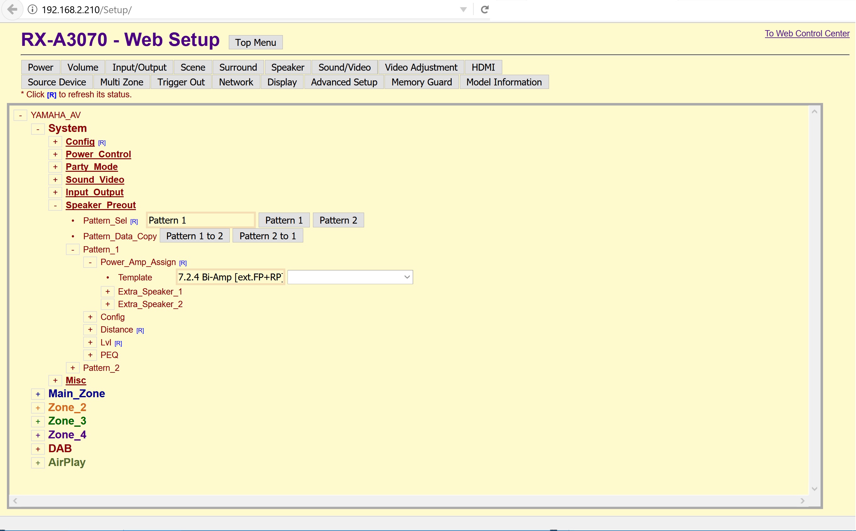

Kan jeg sende dette direkte til en receivers webserver?
Jeg har en Yamaha RX-A3070 som jeg gjerne skulle brukt både til Atmos (7.2.4) og til å drive en ekstra sone når jeg ikke ser film. Da må det byttes mellom to oppsett i høyttalerne, 7.2.4 Bi-Amp [ext.FP+RP] og 7.2 Bi-Amp +1Zone.Jeg sjekket koden på receiverens side, og jeg fant denne DIV-en der:
<div nn='Power_Amp_Assign' y_g=true tp='431'>
 <span><span class='jj' onclick='bb(this)'>+</span>Power_Amp_Assign<span class='rr' onclick='gg(this)'>[R]</span></span>
 <div nn='Template' y_lf='1' tp='431'>
 <span class='ii'><span class='kk'>•</span>Template</span>
 <form class='oo'>
 <input type="text" name='read' class='mm' readonly>
 <select onchange='aa(this,1)' onclick='aa(this,2)'>
 <option value="" selected="selected"></option>
 <option value="Surround" tp='453'>Surround</option>
 <option value="Presence" tp='456'>Presence</option>
 <option value="Sur.Back" tp='456'>Sur.Back</option>
 <option value="BI-AMP" tp='462'>BI-AMP</option>
 <option value="ZoneB" tp='459'>ZoneB</option>
 <option value="5.1ch" tp='455'>5.1ch</option>
 <option value="Basic" tp='454'>Basic</option>
 <option value="7.1 +1Zone" tp='460'>7.1 +1Zone</option>
 <option value="5.1.2 +1Zone" tp='460'>5.1.2 +1Zone</option>
 <option value="5.1 Bi-Amp" tp='463'>5.1 Bi-Amp</option>
 <option value="7.1 Bi-Amp [ext.SB]" tp='464'>7.1 Bi-Amp [ext.SB]</option>
 <option value="7.2 +1Zone" tp='461'>7.2 +1Zone</option>
 <option value="7.2.2 +1Zone" tp='461'>7.2.2 +1Zone</option>
 <option value="7.2 +2Zone" tp='461'>7.2 +2Zone</option>
 <option value="7.2.4 [ext.RP]" tp='458'>7.2.4 [ext.RP]</option>
 <option value="7.2.4 [ext.Front]" tp='458'>7.2.4 [ext.Front]</option>
 <option value="7.2.4 [ext.FP+RP]" tp='458'>7.2.4 [ext.FP+RP]</option>
 <option value="7.2.2 [ext.Front] +1Zone" tp='461'>7.2.2 [ext.Front] +1Zone</option>
 <option value="7.2 [ext.Front] +2Zone" tp='461'>7.2 [ext.Front] +2Zone</option>
 <option value="7.2 Bi-Amp" tp='465'>7.2 Bi-Amp</option>
 <option value="5.2.2 Bi-Amp" tp='465'>5.2.2 Bi-Amp</option>
 <option value="7.2 Bi-Amp +1Zone" tp='465'>7.2 Bi-Amp +1Zone</option>
 <option value="7.2.4 Bi-Amp [ext.FP+RP]" tp='467'>7.2.4 Bi-Amp [ext.FP+RP]</option>
 <option value="5.2.4 Bi-Amp [ext.RP]" tp='466'>5.2.4 Bi-Amp [ext.RP]</option>
 </select>
 </form>
 </div>
Jeg bruker Girder og EvenGhost til å automatisere, og begge kan sende HTML. EG kan også kjøre Put og Get med JSon, hvis det er nødvendig her. Kan noen si meg om jeg kan bruke en HTTP request for å sette disse valgene? Hele webserverkoden er lagt ved som tekstfil, hvis det er nødvendig (zip, fordi vedleggssystemet her nektet å ta den som 2,3 mb tekstfil). Sånn ser severen ut på et skjermskudd:
3070-webserver.zip
Endret av Mastiff
Lenke til kommentar
Jeg har vært innom alt jeg kunne finne der, men ingenting av det kunne gjøre akkurat det jeg trenger. Det er en funksjon som vanligvis blir brukt bare én gang, og det er når man setter opp receiveren. Jeg har også sjekket på AVSForum og ikke funnet noen andre som har autoamtisert akkurat dette. Og der er det ganske mange som har den receiveren. Så den eneste muligheten er nok å få hjelp til å finne ut av det, siden jeg ikke forstår nok programmering til å klare det selv.
