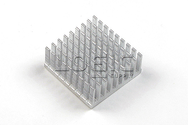

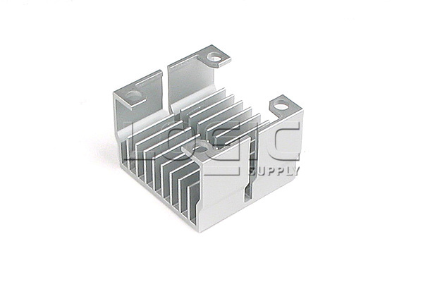

Vil noe slikt virke til kjøling + en liten vifte?
The LP-SBHSv1 is a replacement low-profile heat sink for cooling the southbridge on a mainboard. Comes with a self-adhesive square on the bottom of the heat sink.
The LF-Heatsink is a replacement low-profile heat sink for the Intel D201GLY, D201GLY2A, or D945GCLF mainboard. This heat sink is virtually identical to the stock Intel heat sink, but resolves the height restrictions the original heat sink experienced in much of our selection of Mini-ITX chassis.
