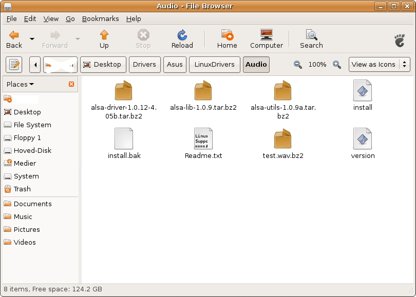

Khaffner Skrevet 8. mars 2008 Del Skrevet 8. mars 2008 Jeg er helt fersk i Linux, nærmere bestemt Ubuntu. Innstallerte idag tidlig og nå har jeg problemer med å innstallere driverne til lyd. Jeg har en Creative x-fi extremegamer, men fant ut at det ikke fantes 32-bits linuxdrivere til den, så jeg velger å bruke lydkortet på hovedkortet mitt. Jeg fant driverne til mitt Asus P5VD2-VM SE og her kommer problemet mitt. Hvordan innstallerer jeg driverne? Dette står i README-dokumentet som fulgte med: Installation: This Source Code is from www.alsa-project.org. Installation notice: 1.It must have GCC compiler in your OS. 2.Kernel source code is the necessary for driver compile. For driver installation, please follow below steps. Automatic install: execute ./install Manual install: Step 1. unzip source code tar xfvj alsa-driver-1.0.xx.tar.bz2 Step 2. Turn on sound support (soundcore module, default turn on) Step 3. Complied source code and install the driver a. cd alsa-driver-1.0.xx b. ./configure c. make d. make install e. ./snddevices Step 4. Install ALSA Lib a. tar jxvpf alsa-lib-1.0.xx.tar.bz2 b. cd alsa-lib-1.0.xx c. ./configure d. make e. make install Step 5. Install ALSA Utility a. tar jxvpf alsa-utils-1.0.xx.tar.bz2 b. cd alsa-utils-1.0.xx c. ./configure d. make e. make install Step 6. Run ALSA auto configuration ./alsaconf Step 7. Use the alsamixer the disable mute (All audio line default is mute) *Must to compile and to install the ALSA library and utility. (Use automatic install is already installed) excute alsamixer Note: 1. The most detail information, can refer the alsa-kernel/Documenttation/ALSA-Configuration.txt in the azx-021705.tar.bz2. 2. Kernel Version must be 2.2.14 or later. 3. All mixer channels are muted by default. You must use a native or OSS mixer program to unmute appropriate channels. 4. If can not compile the source code, try to rename the /usr/src/linux-2.x -> /usr/src/linux. 5. The driver added to support the SPDIF functoin. 6. a. You can download the alsa-lib-1.0.9 and alsa-utils-1.0.9a form the www.alsa-project.org, then unzip and install them. b. Suggest use "alsamixer" to control mixer function. c. Used "alsaconf" can autodetect which drive you need to install (step 4). 7. SUSE Distribution must install the ncurses package. Jeg skjønte rett og slett ikke hva jeg skal gjøre. Jeg legger ved et bilde som viser innholdet i drivermappen noen som kan hjelpe? Lenke til kommentar

Danny Boy Skrevet 8. mars 2008 Del Skrevet 8. mars 2008 Yay Drivere blir som regel automatisert ved hjelp av sånne hjelpemenyer i Ubuntu, så er veldig enkelt, men jeg kan jo vise deg hvordan vi kompilerer en driver, for så å installere den. Det første du trenger er noen nødvendige programme som skal kompilere koden. Gå til System -> Administration -> Synaptic Package Manager. Søk etter Build-essential, og installer det. Eller når jeg tenker meg om så er det en god del å srkive og forklare, vetsje om jeg orker nå Men kan vise litt basis: Du kompilerer fra en terminal. Gå til Applications -> Accessories -> Terminal, eller trykk Alt+F2, og skriv inn Gnome-terminal. Terminalen vil alltid starte der Home mappen din er, altså gå til Places -> Home Folder. Viss du legger LinuxDrivers.zip-filen her, kan du skrive dette i terminal for å pakke den ut: unzip LinuxDrivers.zip Nå skal den bli pakket ut, så går vi videre: cd LinuxDrivers nå er du inni den nye mappen, for å gå tilbake kan du skrive ../ Eller om du vil bort til skrivebordet ditt kan du skrive cd /home/brukernavn/Desktop Så står de neste kommandoene i den README-filen, men det ser ut som det ligger en script der som skal automatisk installere driveren for deg. Denne koden: Automatic install: execute ./install Så det du gjør da, er: unzip LinuxDrivers.zip cd LiniuxDrivers ./install Jeg er nybegynner selv så er litt usikker nå på om det vil fungere Har klart å kompilert XAMPP (serverprogram) og noen andre ting, men aldri en lyddriver før^^ Men litt småbasis her i hvert fall. Du kan få hjelp eller lese mer her: http://ubuntuforums.org/forumdisplay.php?f=44 Godt at det løste seg i hvert fall Lenke til kommentar
